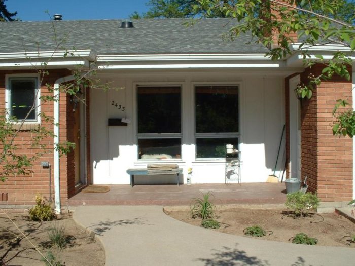

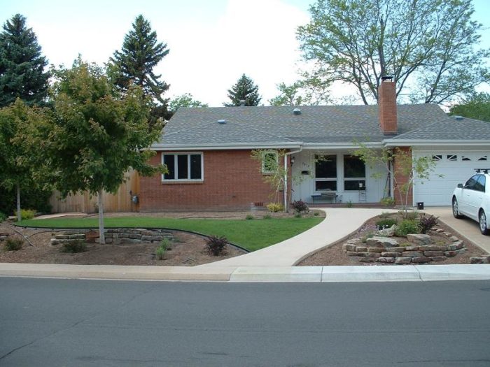

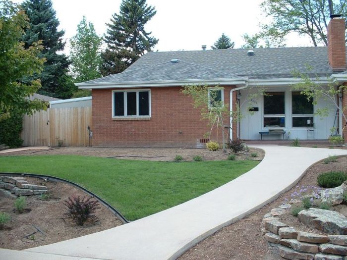

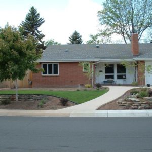

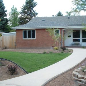

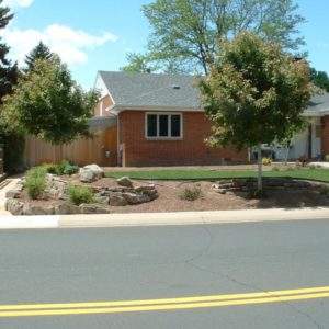

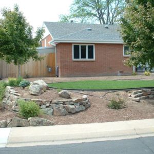

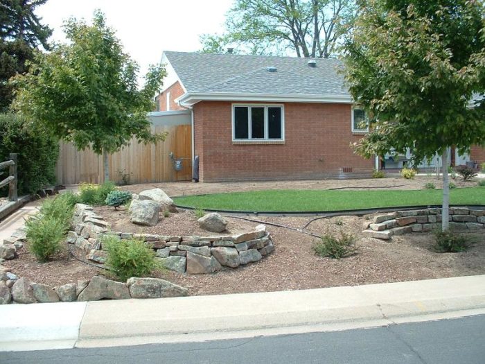

I went out and took some more pics.
The low stone walls add a sense of old rustic charm to the front yard. I'd like to incorporate that into the house front.

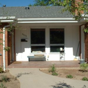

the patio goes on the outside of the window in the middle of the brick wall.
The window will be pulled and a set of doors will lead out into the patio.
I need shade for the patio so a pergola is going over it.
Those things are pretty easy for me. How to tie it together and give it charm is what I need help with.
We live just outside of old town and i want the house to look like it is about 20-30 years older style wise.

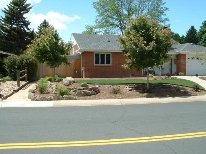

I will include some pics of the house with new landscape in front tonight.

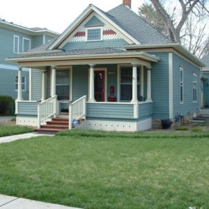

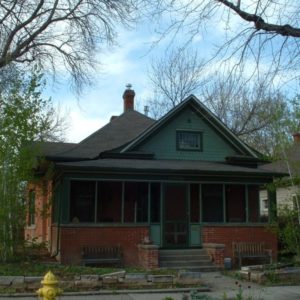

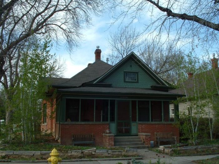

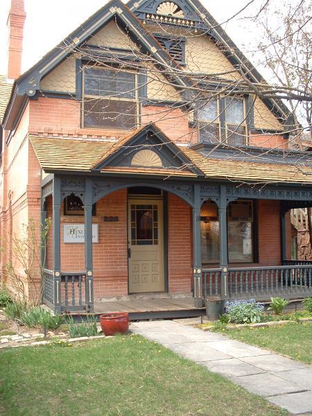

And some old town houses i liked tonight.

There are some issues with the front of the house.
1. The entrance is inside a little porch. One door goes into the house and the other goes into the garage. The landscape designer had me take the front walk up to the left side of this porch. Her idea was to put up lattice work on the right side and grow climbing fragrant vines on it so you would have green wall there that would bring fragrance ionto the entrance. I like he idea of fragrance at the entrance to the house. I like the idea of a green wall.
But I'm not sure if it is a solution that is formal enough for the front entrance. I can build a trelis from scratch out of some nice lumber. I can do a design that has a theme that is reflected elsewhere. I was thinking I could do a stone planter under it so it was more formal. I included a pic of some stonework that is inside the house that would work. It's just inside the entrance. I was going to use this style for the patio wall as well. It is a local stone and style.
2. If you look at the pic of the window in the middle of the brick wall it is wide enough so I could cut the brick and turn it into a doorway. This would lead into the patio from the house.
There are no other windows in this room though. It is a small dinning room with the kitchen behind that. So opening up the dinning room into the patio will enlarge the room and get people out there. Right now nobody uses the dinning room.
3. The reason I brought it up was because I think just putting doors in the room going out to the patio isn't enough. I think it needs a window or two. I would like to put some large windows to the left of the doorway. I would like to have them be fixed large windows. I would like the windows to sit on a stem wall about 24-30" tall. I would like the windows to turn the corner on the stem wall. I would flood the room with light and create a unique modern element.
4. I think there is to much bright red brick on the outside of this house. It dates the house to the fifties and I'm trying to make the house look older. So I wanted to apply sized flagstone along the bottom of the exterior about 24-30" tall. This would cut down on the brick and give the exterior an older look. Old stone is used alot on the homes in this area. Maybe it is a Colorado thing. The sized flagstone would be capped with a piece like a sil anged a bit to shed water. I would like the flagstone cap to be under the windows I put in to the left of the doors. So the cap would be 8-9" wide under the windows on top of the stem wall.

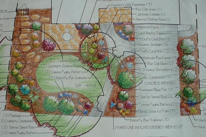

5. The size of the patio was figured out by the lanscape designer and I think it works fine. I included a pic of the lanscape plan. It shows the size but no elevations. I think the wall for the patio should be about 40" tall so you can look over it when you sitting down and say high to neighbors passing by. I want the patio wall to have the flagstone patern I included a pic of with a 2" thick cap on top of it.

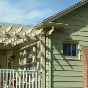

6. I'm not sure how to tie in the pergola to the house. Should the top of the pergola line up with the facia? Or be above or below it? Should the pergola posts die into the top of the patio wall? I could build the wall with concrete posts under the pergola posts. That would tie them together better visually. I could build sleeves into these concrete posts that the pergola posts would slide into.
7. The front of roof in this patio area is a hip. Most of the older homes don't have hips. Should I put a gable end on top of the hip So the pergola has a gable end in back and above it? I could just aplly a gable end on top of this hip California style and put a nice decorative finish on it. It would set the pergolw off nicely.

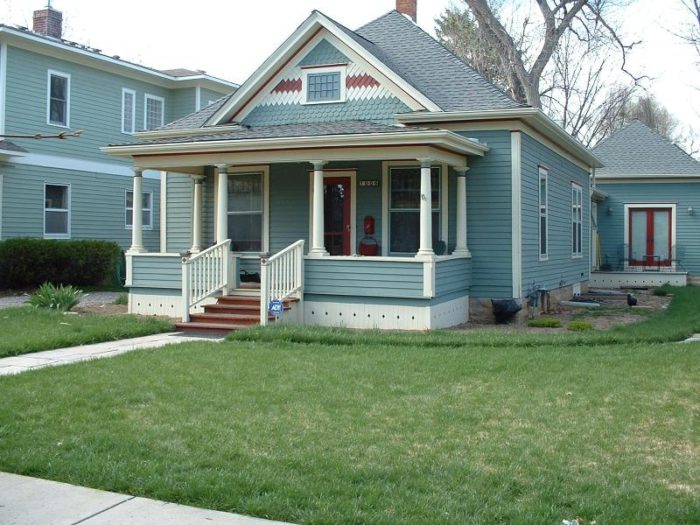

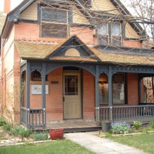

Here are some pics of the front where the patio and pergola is going. I included some pics of older homes. One has a dark rustic feel to it. Not exactly what I'm after but I think darker colors with lighter accents will work. Others are colorfull. With the moss rock walls I put in front I think darker rustic colors would be a better match.
Also, I'm planning on putting a small low pretty dark iron fence in front at the sidewalk. The moss rock and the iron fence will have an old look. Maybe some iron could be incorporated into the patio somehow?

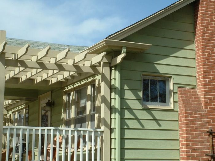

Like you, I think a successful porch re-do should look like its always been there. I just completed a front porch remodel on my mom's place, and one of the neighbors who has lived in the neighborhood his whole life gave me a nice compliment, when he told me he thought it had always been that way. Another neighbor asked, Did you do something different to your porch?

I included a pic of the front yard before I changed the landscaping.
