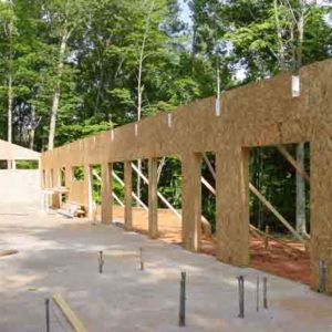

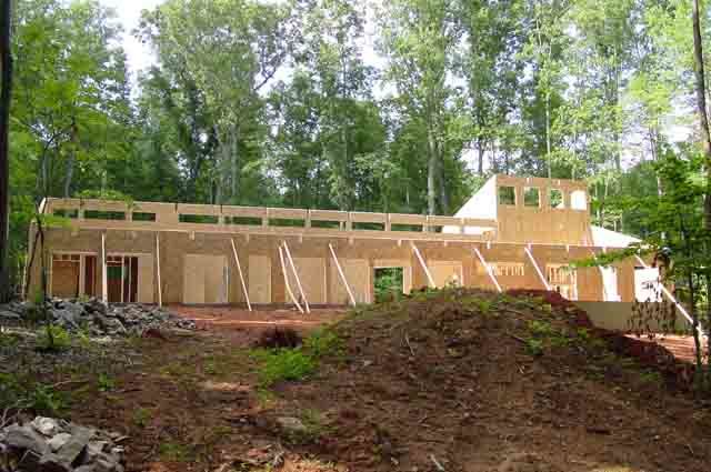

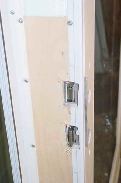

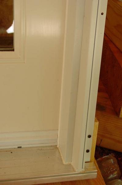

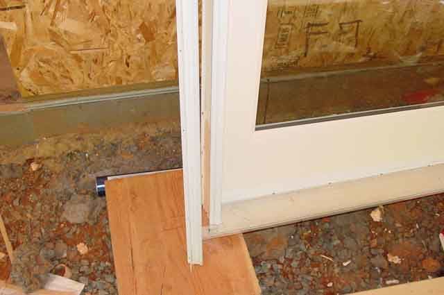

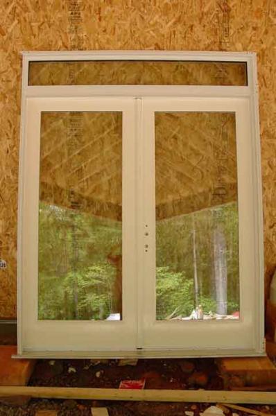

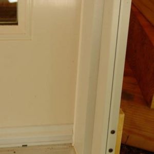

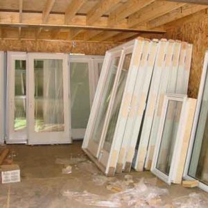

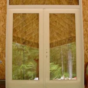

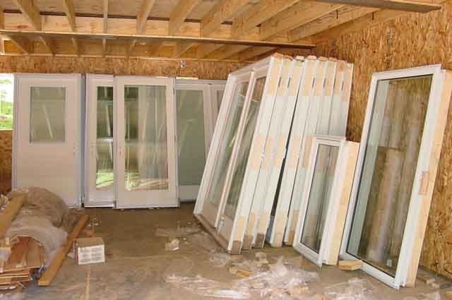

I think my main builder has set me up<G> He’s building this SIPS house, and I have to put the exterior doors in. Thermotech. 16 of them. 10 french.
The SIPS wall panels are 2×6. The Thermotech windows came with jambs for 2×6 wall. The doors all came with jambs for 2×4 walls. Door panels are fiberglass and the jambs are aluminum and fiberglass clad with aluminum nailing fins. The factory also sent wooden jamb extensions.
Obviously, the doors won’t open much past 90° with the jamb extensions on the inside. If the wooden extensions are used on the outside (which is actually what the builder is thinking), the fins are lost, plus any way of sealing the frame is compromised.
Apparently, we can get an aluminum snap in sill extension.
The exterior of the house is supposed get Grail coated up to the jambs, no trim.

  2. RalphWicklund | Jul 25, 2004 08:57pm | #2
    Since there will be no exterior trim you could still use the doors as is. Mount them as if they were for masonry construction, flush to the inside wall as usual and return the Grail coating directly to the exterior of the now recessed jamb.
    I'm sure you can find some way to conceal the fasteners in the hinge area and elsewhere on the flat of the jambs that would not look out of place. Fins would have to go, of course. Trash the jamb extensions but get the threshold extensions.
    1. Snort | Jul 25, 2004 09:57pm | #4
      That's simple. Doors wouldn't match the window frames, but the recess might look cool and help with protection. Thanks Don't worry, we can fix that later!

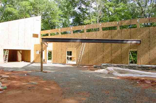

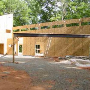

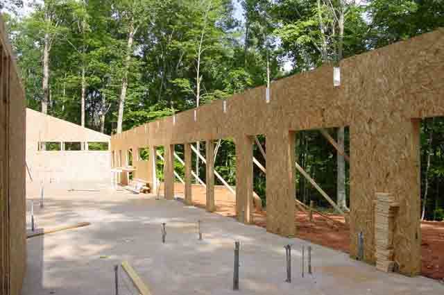

    Why are you useing wall SIPs?
    As per your photos there is more window and door area than wall in your design. It seems to me the heat loss from what little wall area is left will be very little compared to the loss through all those windows and doors. This would make the extra cost of SIP construction senceless.
    Wondering...
    1. Snort | Jul 26, 2004 02:17am | #9
      Super high performance windows from Canada, eh? It's all the homeowners choice. We are just ignorant construction doodes. Don't worry, we can fix that later!

        You have 5/8' to make up on each side of the jambs. That's the wiggle room space in the rough opening, right?
        Since you are using Grailcoat I am assuming you believe the claims that it is waterproof and will not crack or craze and is guaranteed to work directly over OSB. You didn't say otherwise.
        Get some backer rod to fill the space and apply some polyurethane caulk to fill the opening, that starts the closure. Build out the R.O. with another layer of OSB. Leave about 1/8" space next to the jamb. Place a screed or removable spacer between the OSB build out and the jamb. I would put in a mesh corner bead. Apply the grailcoat. Remove the spacer. Apply another bead of poly caulk between the jamb and the grailcoat. Done.
