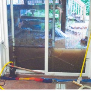

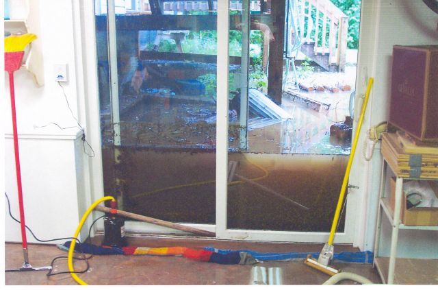

          jocobe | Sep 13, 2006 02:17pm | #23
          Andersen Permashield patio door at it's best. I haven't found one yet to leak that wasn't due to improper installation.View Image
