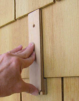

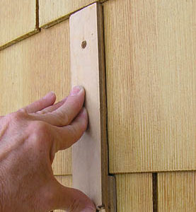

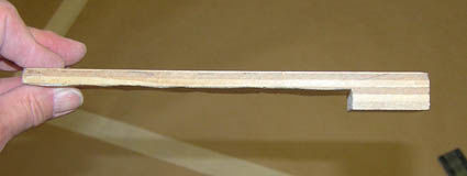

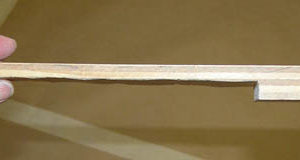

          1. JoeDy | Sep 26, 2005 06:28pm | #33
            Thanks so much for your experience with the hardie shingles.  Would you mind describing the type of wood gauge that you made for holding the panels in place.  I have seen some kind of metal clips that you can buy for holding siding, but if we could make something up that would be great.
          2. kestrel | Sep 27, 2005 04:27am | #34
            Joe,
            I'll get a picture of it for you tomorrow.
            kestrel
          3. kestrel | Sep 28, 2005 05:16am | #36
            Here are the pictures.  The gauge is just a small piece of plywood, notched for the amount of exposure wanted.  The notch slips under the previous row of shingles and supports the shingle being nailed.  We found it considerably easier then trying to align the shingle to a line.  Unlike the bracket that is sold for installing lap siding, this has to be held in place, so you do need a second person.
            One thing to watch for in the Hardie shingle panels is that there may be variation in panel height between pallets.
          4. JoeDy | Sep 28, 2005 06:49pm | #37
            Kestrel,
            Thank you for the pictures of your wood gauge (easy enough).  Using this gauge did you just make sure that you chalkmarked the first course or did you still do every course?
            Thanks, Jody
          5. kestrel | Sep 29, 2005 04:12am | #39
            We didn't have a problem keeping the courses level.  We did snap lines for the first courses, which is a filler strip, one layer of lap siding and then the first course of singleside.  Also in areas such as over our entry, a line helped get the first course level. For the rest, including crossing sliding glass doors and windows, just the gauge was enough.  Of course we kept checking with a tape measure and level, just to be sure they were going on level.  It really was fairly easy to install.
            kestrel
