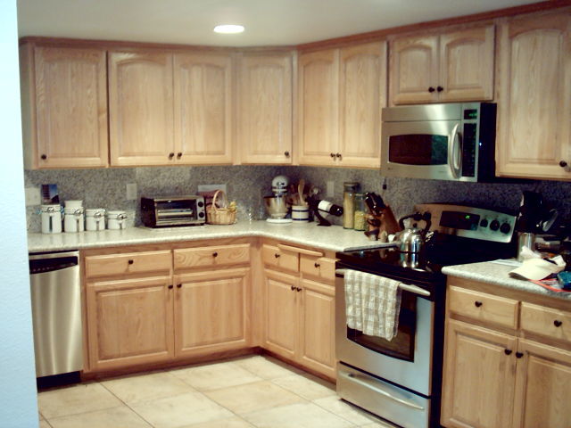

These folks like theirs darcy..............still. I think the panorama window makes it. When I pulled the sink frame fwd, it opened up room for the crappola shelf. This one a regular sink w/drop down divider from Kindred.Remodeling Contractor just outside the Glass City.

That's the most sensible behind-the-sink shelf I have ever seen.
Does the plumbing & electrical for the DW run under the cabinet floor, or did they have to 'short' one of the drawers in that stack?Occupational hazard of my occupation not being around (sorry Bubba)
capn, thanks for the complement, even I get a good idea once in a while.
Going on memory (ha), but in the stock cabs, there's enough room at the back of the drawers to run the drain, the elec came from the usual lower wall right.Remodeling Contractor just outside the Glass City.

Boss tried to talk them in doing what you have done, since all the new cabs were custom, but they wanted that sink. It was like that pre- remodel, so I guess they are used to it.
Also, I was thinking that the sink doesn't look very kid-friendly. . .
Yours looks great! It allows for more space for loading the dishwasher. Nifty shelf.
