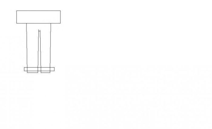

I was at the lumber mill today and while I was waiting I was perusing the “store” and in their bolt aisle I saw a bin of these:
Maybe 3-4″ long, 1/2″-3/4″ accross with a thin nut on it.
Any ideas?

  1. BilljustBill | Jun 06, 2009 10:00pm | #1
    Some of the mobile/modular homes have to be tied down with stakes driven into the ground and galvanized metal straps connect between them.
    The slotted bolt allows the strap loop to go through the bolt and then locked down with the tighten nut.
    Bill
      cyb | Jun 07, 2009 04:06am | #5
      I think you're right, but there should be a square shoulder on that bolt. Also it probably would have been stocked next to the anchors, which should be a big hint as to there porpose.

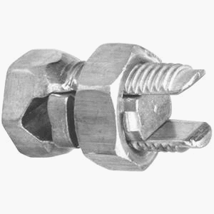

  3. WayneL5 | Jun 07, 2009 05:43am | #7
    Is this it?
    It's a split bolt connector, used for connecting electrical wires.
    http://www.bicsuperstore.com/Split-Bolt-Connector/M/B000LNMX7O.htm
    1. BilljustBill | Jun 07, 2009 07:33am | #8
      Wayne,
      Not it.  That's a pic of a large gauge copper wire connector and they are a bit costly, too.

      Sailfish | Jun 07, 2009 12:35pm | #9
      nope it was pretty much exactly as I drew.-----------------------------------------------------------------------------
