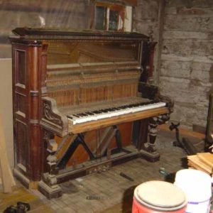

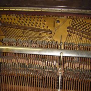

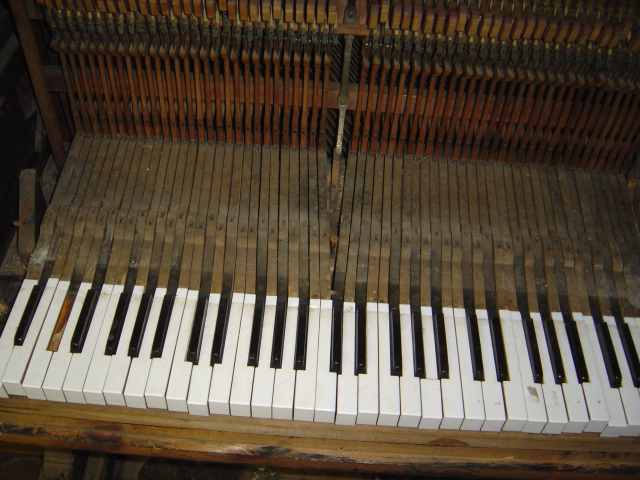

ok, I wuz bored,,I tore into it..it is a early 1900 sumptin…Wing and sons PIannya…had mecces an snakes..outta tune, craked sound board,,but danm fine walnut.
can ya tell..it’ll play?

Jus gotta pull out the key slips, shellac and wax them, some graphite spray on the pivots and tune her up. Gonna let the cracked sound board be that way, it's not fixable.
I have heard that sound borads can be fixed. Maybe not new but far better than current condition. It probably would entail taking the piano apart. You shove some glue in the cracks and clamp it together with hot melt blocks.

I can't tell ya about it...but, ya can get the serial# (not the patent dates) and google the piano's manufacturer name..find out about when they were producing and any other tidbits. Then take that info to PIANOBLUEBOOK.com (I think) and might get an idea.
If it don't take a toatl rebuild, it might be worth a tuning and clean up. IF NOTHING ELSE SAVE THE KEYS!!!!!!!!!!!!!!!!!!!!!!!!!
Ebony and Ivory is getting scarce..to say the least. About all ya want off a junk piano would be those parts, some idgit (like me) would pay for them. The ivory will come off easily, the ebony can be a bit trickier.

Nope, won't fly..the difference of mass betwix teh JB and the spruce is a deadner..like a guitar top is fixed with a spline, sliver or splint, inlayed into the original crack, or a newly widened crack.

make a new SB? NOT in this lifetime..I could buy 5 pianos for what I'd charge myself.

Yup, a "Wing an Sons" can be valuble..they were actually pretty good pianos, Some had a fourth pedal, IIRC it was a mandolin sound or banjo or sumpthin..god , I can't imagine a banjo sound..yikes, actual banjos are bad enough..LOL
I'll see how she rings when I get her tuned..that is a suck job..takes me almost all day. Just waitin for the sound board to explode as ya tweak it "just a bit" more..lol

My wife has a Marshall & Wendell upright she had restored a few years ago for about $1800. She did it because it has been in the family, and she hated to see it get sold for $10.
The piano restorer told us up front that upright pianos in general are not worth restoring because the end value is usually less than the cost of restoration. He said ours is probably a wash, although it would probably be tough to find a buyer.
Sentimental value is the most common reason he gets hired to restore them.
A cracked soundboard is probably a fatal flaw, as far as monetary value goes. What does that do to the sound?
John Svenson, builder, remodeler, NE Ohio
Fatal yes..sound? I dunno..it may not tune at all, without selfdestructing, 264 strings @ 200 (average) lbs is a lot of tension...the harp rail carries the load, the SB mostly reverbs the hamonic resonance..I am certain it'll "rattle" on a few notes..I hope it's all the same note at least.
I've seen worse, that played fine, and sounded damn funky.
