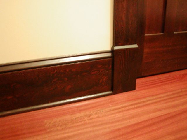

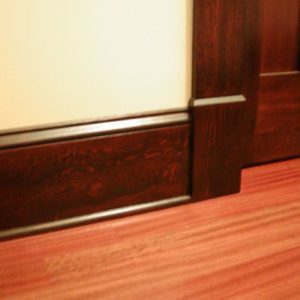

  4. calvin | May 26, 2006 10:12pm | #7
    How tall is the base?  And what profile?
    Here's something out of a 20's-30's house.  Conventional shoe would have been too squat.  Used bullnose stop to add to the salvaged parts, matched what they had quite well.  On some here in NW Oh, the tall base had an OG like stop applied as shoemld.

    1. corrib | May 26, 2006 10:36pm | #8
      Nice work, Calvin!
      I think I will be going with the base shoe versus the quarter round based on everything here.
      Still not sure about what to do with the ends though. The 22.5 cuts would probably be quicker than cutting the returns. I'm not sure.
      If anyone's got any thoughts about using returns or tricks for cutting  them I'd be interested.

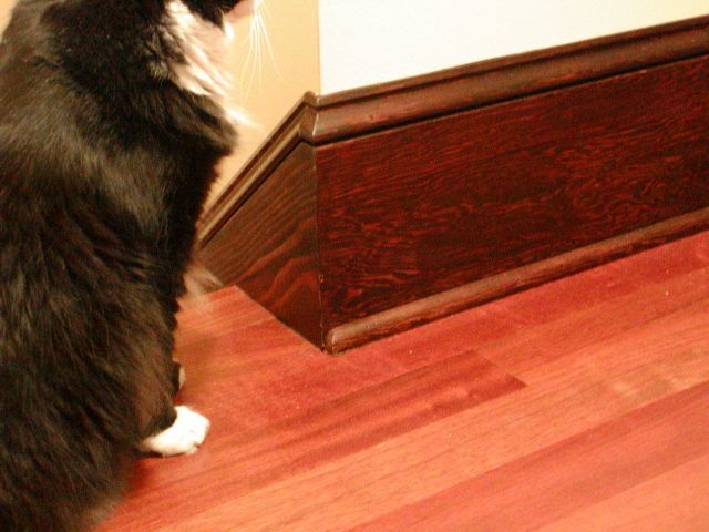

        1. corrib | May 29, 2006 12:13am | #25
          Thanks for all the great advice and pictures.
          If all goes well, I hope to be posting pictures of my own tomorrow at this time.

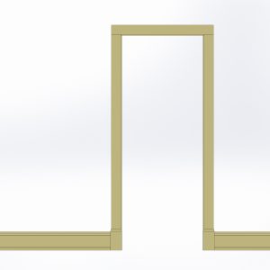

        1. vlorenzi88 | Jan 03, 2022 10:50pm | #28
          Calvin, I appreciate your reply. I actually tried mocking it up this weekend and got thrown off with the reveal because I didn’t think outside of the box. I assumed very similar dimensions as you, except where I went wrong was with my jamb to casing reveal. A uniform bevel or maybe an elliptical round over (looks like this is what is in the picture) on all three sides will work with a 1/2” reveal between the casing and jamb. Although, isn’t a 1/2” reveal really heavy? I feel like I am more used to 1/4” to 3/8”, which will obviously be a problem with 1-1/4” thick plinth.
          1. calvin | Jan 04, 2022 07:10am | #29
            The reveal will be dictated by that bevel or whatever on the plinth block. Less is better you bet! Too bad he didn’t catch that reveal in a photo. 3/8” would be alright once the finish is applied.
            Personally I’d just knock the sharp edge off the top or as is sometimes seen, bevel (clip) the top front edge of the block also.
            This would make the block “appear” not as thick at the top.
            Damn plinth would have to be close to 1-1/4” to catch the whole end of the shoe.

        2. vlorenzi88 | Jan 05, 2022 09:16am | #30
          I ended up modeling this all up and think I got what I want. I was able to achieve 3/8” reveal on the jamb and ended up doing two different bevel angles. The side bevel is a different angle than the front bevel by about 7 degrees. Let me know what you think! I am using 1x6 for the base and 1x4 for the case. Shoe is 3/8” thick. Plinth is 4-1/8” x 7-7/8” x 1-3/16”. Ledge between case and plinth is 1/16” all around and is 1/16” in from door jamb.

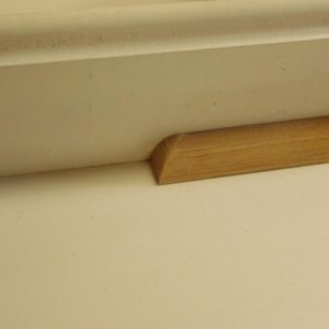

    1. DonCanDo | May 28, 2006 05:09pm | #22
      Thanks, that's a good tip.
      I decided to try it and see what it looks like.  In the picture, the left side is just a miter and the right side is the "cut return".  Of course, that outside corner wouldn't really look like that.  I was just trying to do a side-by-side comparison.
      In my opinion, I think the miter looks better, even though the "cut return" is more elegant (especially if it were actually painted).
