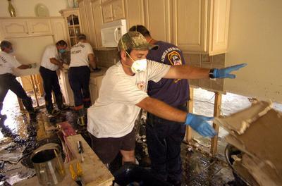

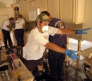

          1. marv | Sep 28, 2005 12:41am | #12

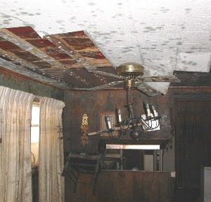

            You need to gut the house to the water line and let dry out.  It may be too late already.  Mold in houses in New Orleans is already to the ceiling (see pictures at NOLA.com).
            Here's a picture of a fireman who got into his house very early with his buddies.You get out of life what you put into it......minus taxes.
            Marv

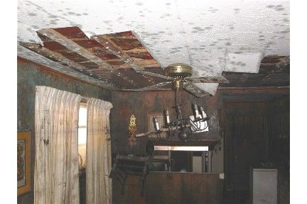

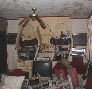

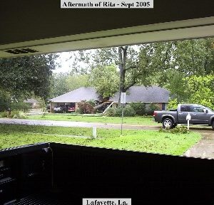

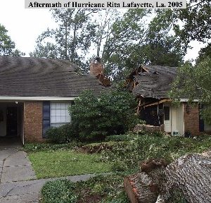

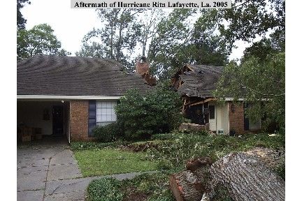

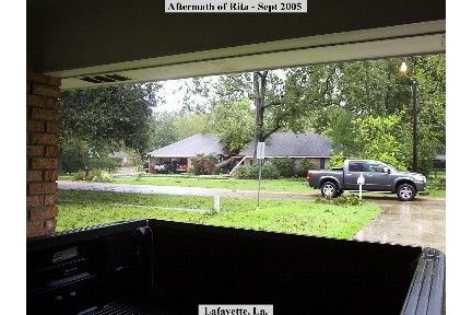

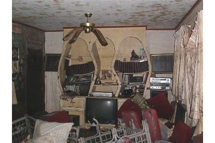

    1. gstringe | Sep 28, 2005 04:07am | #18
      Here are a few pics of the aftermath in New Orleans and LafayetteI like your approach....now lets see your departure
      1. joeh | Sep 28, 2005 06:24am | #19

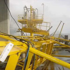

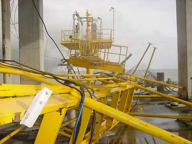

        A friend sent some pics from one of the rigs - this is post Katrina, not Rita.
        Joe H
