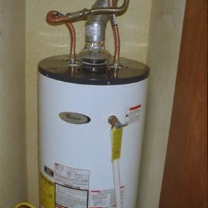

Bought a “new” LP gas water heater that was returned to Lowes for $175.   When I installed it, something was wrong.  Overnight, water was warm, not hot.  When the burner kicked on and the cut off after water was hot, it would get cooler about half way through a shorten shower…never, ever had one do this.  Got Lowes to take it back for the full credit of that purchase price and paid them $250 to install the exact same size new one bought at retail price so vent pipe would fit.
  Before installer arrived, I drained the tank for him, and disconnected one pipe to allow a quicker draining.  He comes and in a few minutes another Lowes Rep. brings 18″ copper flex pipes and puts a “Lowes’ is here” sign in the front yard.  The gas cutoff is the old floor stove faucet with a 1/4″ threaded tip.  Installer said the line in the $24.95 install package isn’t the right size or length.  I leave home and go buy the new yellow gas line and fittings that cost $32.00.  One of the 18″ copper flex pipes wasn’t long enough so installer use two short ones with a nipple to connect them…
The store called a few days later and I told them that it didn’t leak, but it didn’t look like a Professional Job…. got no response by the young girl calling….  This is what I got as far as an installed water heater’s plumbing.  What would you say to the store?

    The original heater was probably installed backwards or the dip tube was broken.
    The new install isn't pretty, but appears functional. (Can't see enough detail of the flue and gas connection to say with confidence, though.)

    Sure it doesn't look pretty.
    but if you have nothing else to do with your time than sitting looking at water heater hookups, you should go start a business, or volunteer to help out at school or a boys club.
    Only one important question here - when you step in the shower, it s the water hot?

      The installation certainly is not very professional looking but it probably works as well as a nice tidy job would.
      As long as it works right, I'd bet 99% of average consumers don't give a hoot what it looks like and spending another 100 clams to make it look pretty just aint gonna happen.

    does the flue pipe have foil tape onthe joint?
    thats a new one for me.

      Yes, it's that heavy-duty aluminum tape that has the mfg. date stamped in red on the shiny side.
      Actually, we finally got our hail damaged roof replaced last October.  The aluminum tape was put on the seam/joints of the double walled vent pipe by the roofing company's quality control inspector after he said he made sure the flue pipe had the 1" space and cleared all wood parts in the attic and as it exits the roof decking...  He did the same thing with the LP gas furnace flue.

        Actually, the tape is doing squat, the vent is a negative pressure zone.  Besides he missed all the joints on the elbow.

    Are there 3 screws in each taped joint of the vent?
    Is the pop-off extension piped to within 6" of the pan/floor drain?
    Is the pop-off pipe CPVC (not the white colored plastic pipe?
    Is there a catch pan or floor drain under the HWH?

    I have never seen foil tape used on B vent like that. Screws either. I have installed Metalbestos B vent a couple of times and no tape or screws were used. It's been a few years, maybe that has changed?
    I would call the pipe manufacturer and ask them if it's supposed to be there. You might be able to find their product info online and look at the install instructions.

      Three screws have been required in each metalbestos joint or any exhaust line since I was installing wood stoves back around 1980 at least.

        Last time I installed Metalbestos B vent myself there was 4" and 6" pipe involved, this was around 1998 in CA where I lived. I don't know if it's the same pipe as shown on this site:
        http://www.selkirkcorp.com/MetalBestos/Product.aspx?id=70#
        but likely it's similar. The pipe has snap-lock couplings for 3" thru 8" sizes and no screws are required, although the install instructions (you have to choose a link at the right, I can't link to it because it's a popup) say that 1/4" screws may be installed if req'd by the AHJ. The AHJ where I was had specialty inspectors, in this case a couple of mechanical inspectors who came out to inspect this type of work. They absolutely forbade screws in the pipe, apparently because too many people used screws long enough to pierce the inner pipe, which obviously ain't good. They insisted on the correct straps and pipe supports so that's what we did.

          Yeah, probably a local AHJ thing - but at the same time, probably 60% of the ones where it is required still don't get it.
      2. rich1 | Jan 11, 2009 11:35pm | #26
        b-vent for gas, no screws.  wood vent is a different animal.

    It is easy to say "you get what you pay for", but there are many fingers in the pie with these big box install arrangements.
    The person doing the install has to move quick if any money (profit) is to be made- moreso if the installer is treated as an independent contractor.
    I wouldn't use a gate valve- only a ball valve.
    The nipple connecting the two flex joints is galvanized steel, and may cause problems with the copper flex which is thin to start with. If a nipple is needed, a brass one can be had for a few dollars more.
    There is no need or reason for any kind of tape on flue joints (especially type B vent), and it may actually be against code.
    There is no skill in the install as pictured. Anyone that can screw fittings together can do that. You could have saved yourself $175 and done it on your own.
    Sure looks like the flex line going from the nipple to the wall is stainless steel. I hope the "pro installer" didn't use a gas flex line..... Nothing wrong with the stainless line as long as it is approved for potable (drinking) water.

    First thing I noticed is no seismic strap to prevent tipping over. Is that just another Ca. thing?

      They aren't required in NE Ohio.John Svenson, builder,  remodeler,  NE Ohio

    I'd call the local BI and let him look at it. Lowes did pull a permit right? If not even better.
