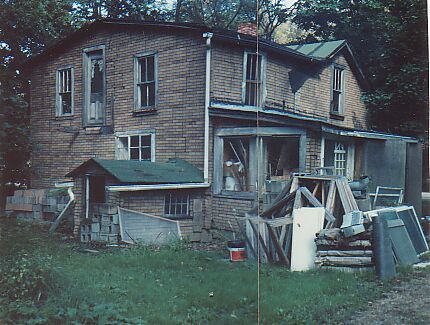

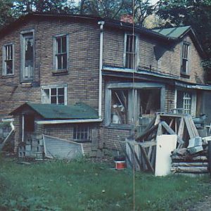

          3. jhyer | Feb 26, 2003 10:22pm | #18
            WOW!  What a beauty! :-)
            Just wait... I'm getting a digital camera (maybe I'll borrow one for the weekend)... After those pictures, I'm feeling a bit better, but I'll let you folks be the judge of the work to be done.
            Lots of potential and it is liveable (for now).  Also neat little outbuilding that has turned into the Tool Box and Lumber storage area.
            Words just aren't doing it justice... I'll get pics.
            Termite damage to repair, full mechanicals to relocate and replace (city sewer and city water work to be done) conversion to gas in the future, change from old steam system to CI radiator forced hot water. complete remodel inside and out.  asbestos shingles on the exterior, remove chimney and put up new one in addition.  add staircase, relocate driveway.
            just a short list, but I'll be looking to all of you folks to give advice on how to organize it in the near future.
            Thanks in advance,
            J
