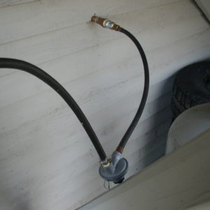

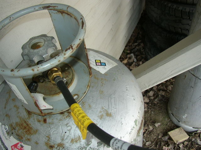

    1. WorkshopJon | Dec 01, 2006 12:20am | #23
      Hi Mike,
      (had to post to someone and also haven't chatted with you in a while).
      All,
       My detached building is hard plumbed from the heaters to the outside.  My only concern was if a hose clamp was sufficient  on the high pressure side (outside) of the system.  I've attached 2 pics so you all can see what I'm doing.  BTW, system works great.  90,000 BTU's. for 1,000sq/ft.
      1. booch | Dec 01, 2006 01:24am | #24
        That looks fine in my book. The pressure is insignificant in the rubber after the regulator if it leaks there it won't be as exciting a leak. Had you hard plumbed it the continual bending of soft copper would mess up the flaired fittings if the pipe wouldn't break.
