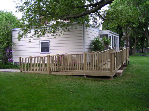

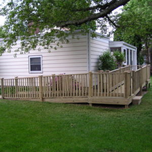

    Me and some guys from our church did one for an elderly woman who had to come home from a hospital stay in a wheelchair (she was not happy about that!).  It ended up about 1:14 or so (shallower than required) and is just 5/4 treated decking.  As far as I've heard, neither she or her husband (both about 86 years young) haven't had any trouble with the traction.  It's been up about one full year now.
    The idea was for this to be a 'long-term temporary' ramp so we just set PT 4x4's 36" into the soil to support each landing and mid-span of the ramp sections.  Everything worked out great and she was thrilled.
  10. KevinH | Mar 30, 2006 05:18pm | #12
    Tried to attach a photo to the last post but must've missed something - here goes again...
