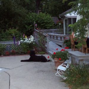

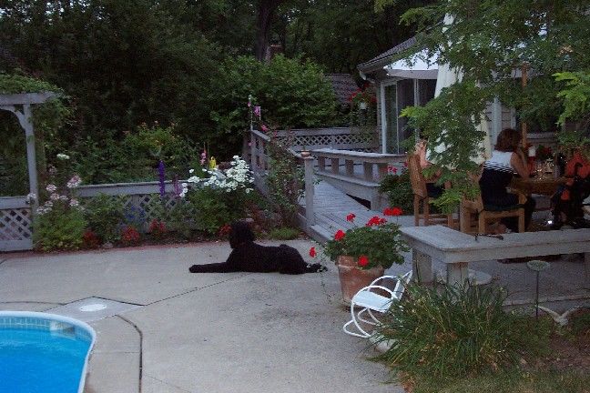

        GD, an important thing along with a rail is a "curb" along the edge of the ramp.  This will keep her wheels on the ramp and the event of a walker or crutches, gives the added safety so they don't slip off.  The photo shows a deck with ramp for a motorized chair which might help you fine tune the design.
        This had a 1*12  and the ramp run was about 14'.  You might consider a landing somewhere midway, they gather sizable speed going down and perhaps could use a break pt. on the incline.  Seems I remember something about 17' as a max suggested run w/o landing.  Hope this gets to you b/4 you start.  Best of luck to your friend.Remodeling Contractor just outside the Glass City.
