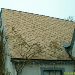

Who or where makes a replacement for these things?
Joe HView Image
Edited 3/24/2005 9:17 pm ET by JoeH
Joe HView Image
Unless you get lucky in a salvage yard, I doubt you will find any source selling an asbestos product these days. You may want to try resources from preservation websites. I believe there is a cementitious look-alike available. Good Luck.

How many do you need? Is this for a repair or a new roof? How thick are they? Could you cut them out of Hardibacker and stain them?
New roof. I don't think that fuzzy edge of cut Hardi would look too good, and how to stain them and have it last?
The ones in the picture are probably 60+ years old and still have some color to them. There are a number of these old houses locally and the shingles are all different colors. Johns Manville Lifetime Roof, they weren't kidding.
Need to find some reproductions, they must be out there somewhere.
Joe H

I'm removing a large roof with the same asbestos shingles you picture.
Atas is the closest product I could find,but the owners decided to replace with slate with just a square butt.Sacrificed the diamond look for a 100 year roof.
Good luck
How many of them are salvageable? Might be the only way I'm going to get them.
Atlas makes a round bottom shingle, regular 3 tab with round tabs. Looks ok on their website, but still not what I'm after.

I'm just starting to remove these tiles,but they're treated as special waste here in Maine.I had to become licensed in order to remove them,and have to wrap them in two layers of 6 mil poly in order to dispose of them.
They were installed over cedar shingles so they are pretty cupped and worn.I'm salvaging some for repairs to other roofs of this vintage but most are headed to a secure landfill.
Even though these are non friable it's still regarded as a hazardous material and regulated by the DEP.
We're putting on new North Country Black slate of 10x 16 inch size

Those are what we called Dutch Lap shingles ,different animal then the asbestos/cement .

Where are you located? My Dad who is 80 this year started roofing in the early 50's in southwestern CT. A product that looks exactly like what you have there was manufactured in Stratford, CT by a company called TILO (ty-low) and were called something like Diamond-Lock. They were not available to the average contractor. They either had their own installation crews or you had to be a certified installer.
I don't know exactly when but they stopped producing that shingle a long time ago. And the company also went out of business.
A side note: They also produced a standard three-tab shingle which anyopne could purchase. These shingles had a slightly different feature in that the slots were slightly wider than other brands and had a square rather than rounded top. These shingles went by the name of TRIPPLE "A". They were absolutly the best shingle made at the time but hard to sell due to name recognition. I can find you post-WWII homes that still have these shingles on them today.
