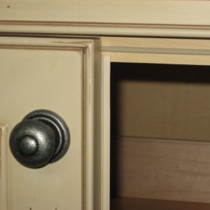

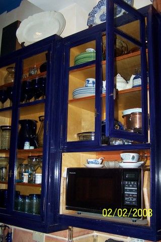

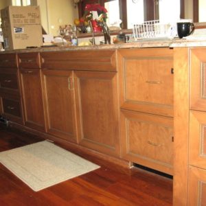

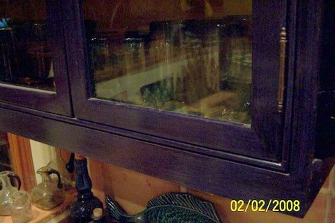

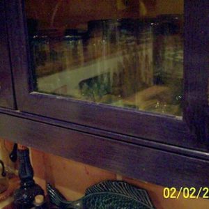

    I've done the cockbeading several ways and I don't think there is a right or wrong. I prefer to put it on the faceframe, easier to do, more pleasing to my eye but in many of the antiques that I have the cockbeading is on the drawers if its a chest and on the frame if its doors.
    Here are three samples
