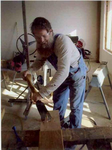

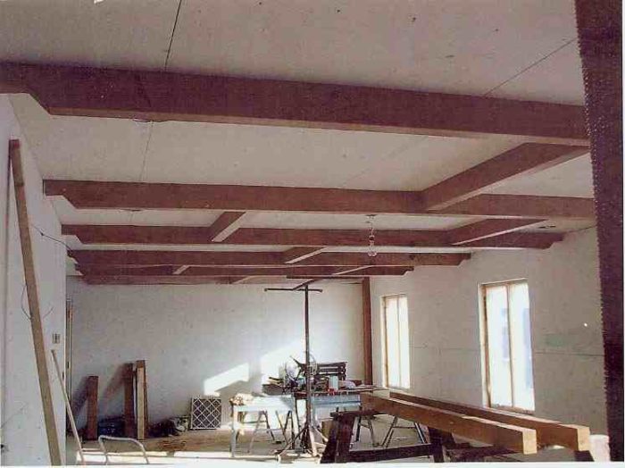

got called in by a friend to help beat a deadline – took 4X6 white oak rough sawn and turned them into a beamed ceiling – – finished with the posts up the walls today – plasterer starts the room tomorrow while we start trim in the master bed/bath – 1500 ft of rough walnut/cherry/red oak to turn into flooring – a good job with a pleasant, eccentric owner who doctors give 90 days to live – suppose to get this done so he can live in his new house before he passes – – sure wish I could have started in january – my helper/equal took these photos – I’ll post some more here as it progresses –

Who's the ugly guy with the big chisel ???...................(-:

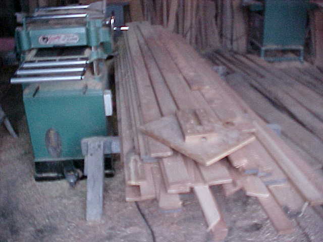

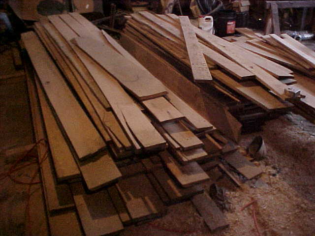

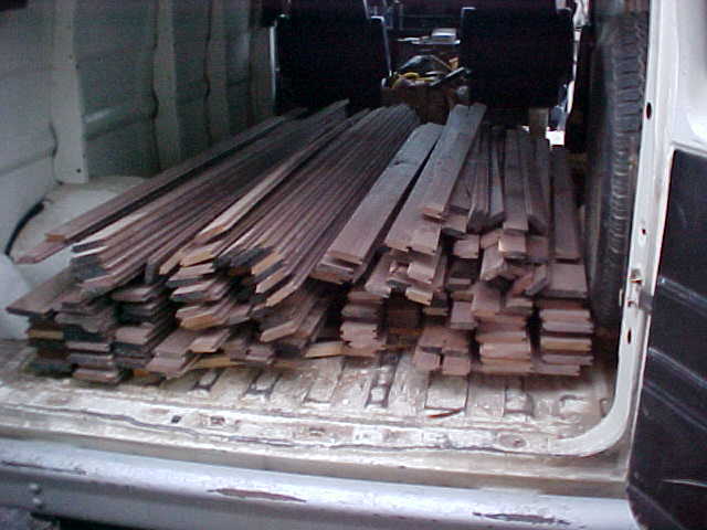

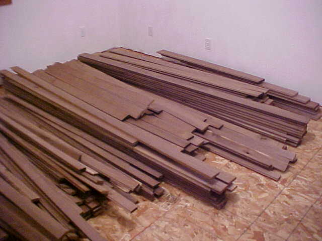

well, it's been a busy few days - Jarie and I have been trimming in between lots of other tasks - the owner bought a pile (several piles actually) of lumber - oak, walnut, and cherry - the various rooms are trimmed with differing species in a specified style - Dale calls it 'Pondarosa' - we take rough boards and manufacture trim - a slow process - here's the master bath -

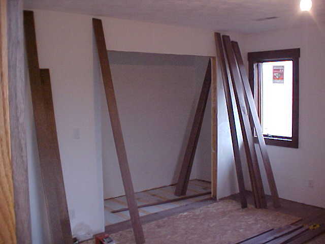

we've selected boards and have begun the trim -

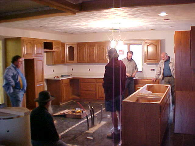

cabinets are mostly in - note the plasterwork -

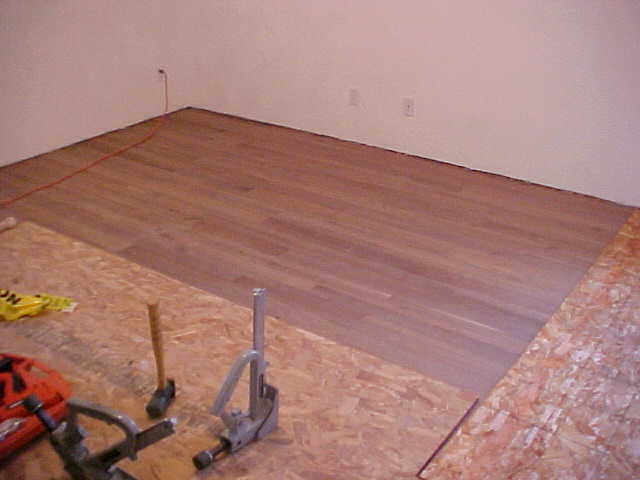

in response to overwhelming demand, (thanx Neil) here's a few more picts as the project continures - we layed the floor in the 'cherry room' (second bedroom) and the oak floor in the living room -

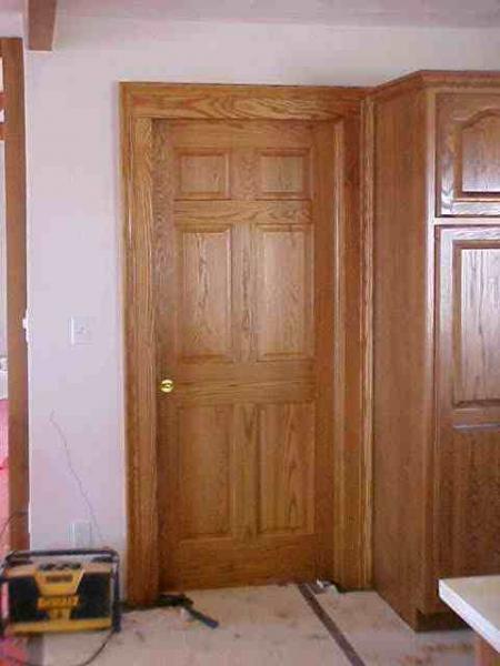

...but was discarded and instead we went with this style - I've got all the molding and casing made, and have done 3 doors, but are waiting to get the floors sanded and finished before hanging the rest -

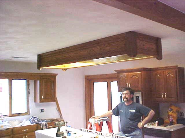

we built a light box for the kitchen...

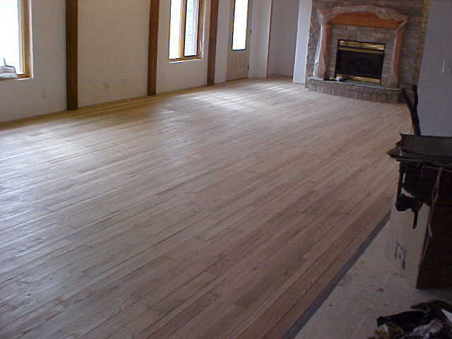

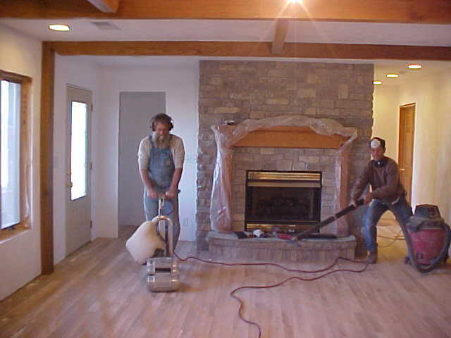

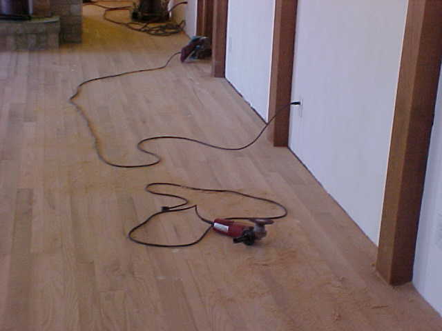

yesterday we finished laying the oak floor - we had to manufacture more and give it a few days to acclimate - so today, clear the decks, head for the rental place and haul the vintage 'Clarke DU-8' and major orbital sanders to the site and start making dust - nothing like the smell of 20 grit in the morning - please don't laugh, Ditch -
a little work around the edges -

thanks for the complements, Tim - - the trim/floor is being manufactured from rough cut boards that have air dried for 10 years - we took the material fro the floor to a local shop, we justd don't have time - - the molding/rail for around doors etc is turned out on a jet moulder/planer - the doors are purchased, oak veneer over particle board - they are very clean/straight/handsome, but I didn't know you could make veneer that thin - - the HO bought $6K worth of WW tools to do this job, when he still had his health - unfortunately (i guess) he has several machines that we just don't need/use, wish I would have been on board from the begining, instead called on for the bail out, could have saved him some money - I'll take a couple of picts of the shop/tools we use for the job, if you're interested - -

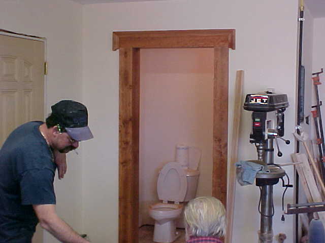

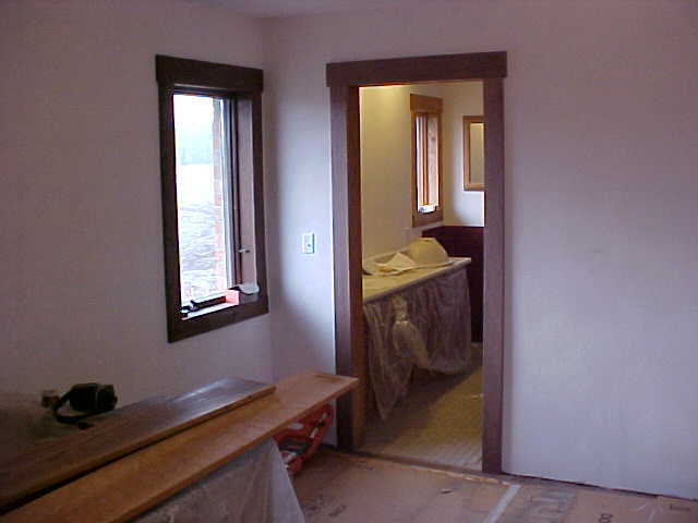

we've been working on the trim scheme - the prototype was in cherry around the door in the garage restroom -

Drill press on site? wow, never seen that before, at least not a stand up model
Garage restroom?

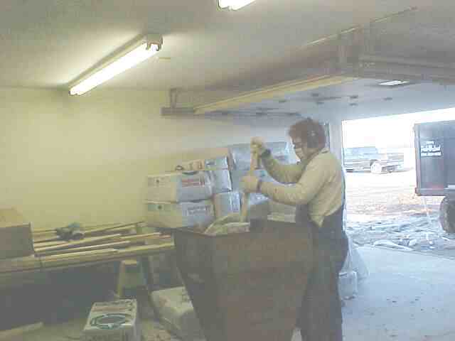

lots of other jobs going on - Tom is plastering -

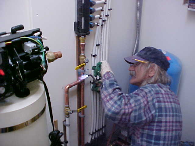

the Culligan Man showed up today, along with a water heater - Kraig kept after the plumbing -

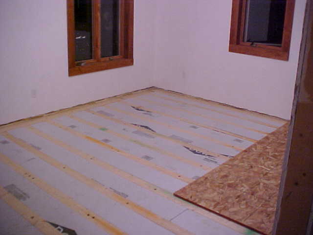

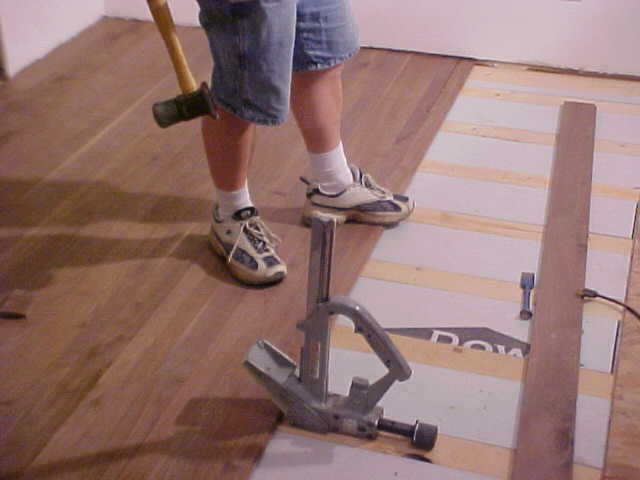

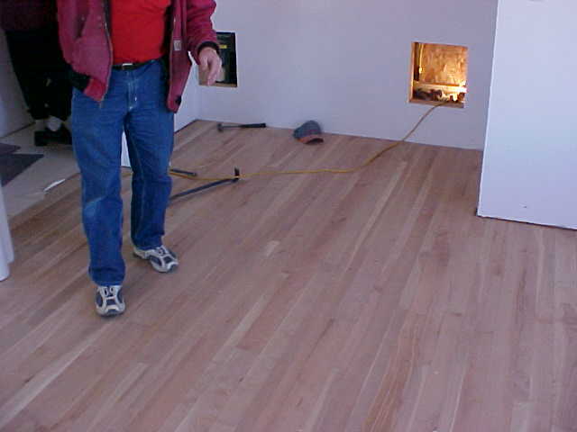

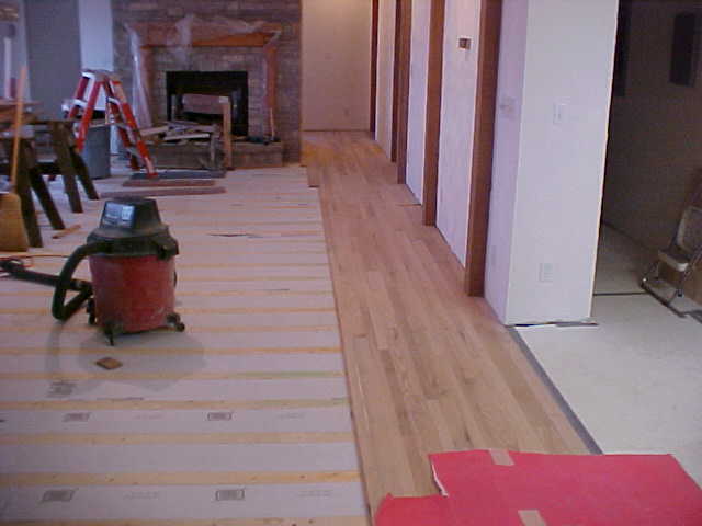

Jarie and I 'Tapcon-ed' nailers on 12" centers to the floor of the Cherry room - concrete men left a hole right inside the doorway that took as much time to massage as the rest of of the room took to do - we tacked down some OSB for a temp floor as this will be the last room to recieve flooring - unloaded the walnut flooring (for the other bedroom) and stashed it in the cherry room - tomorrow we'll sticker it and let it aclimate till monday -
well, a lot done in a week, I guess - walnut floor is down -

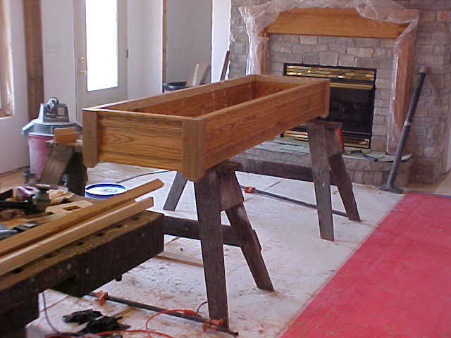

a few other tasks assigned - warning: trim carpenter at work -

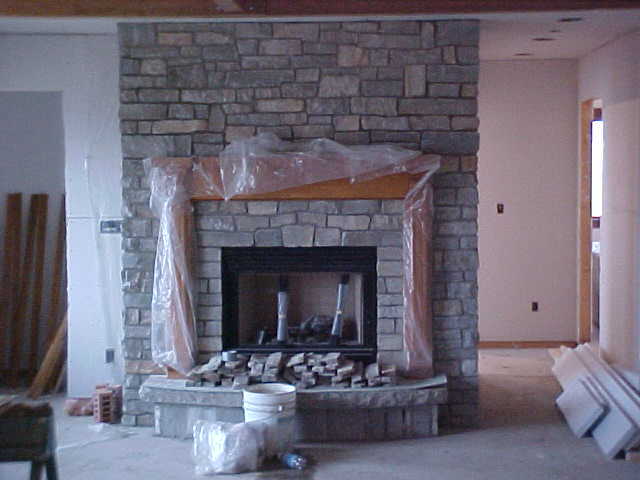

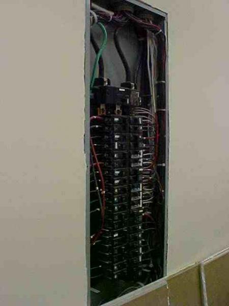

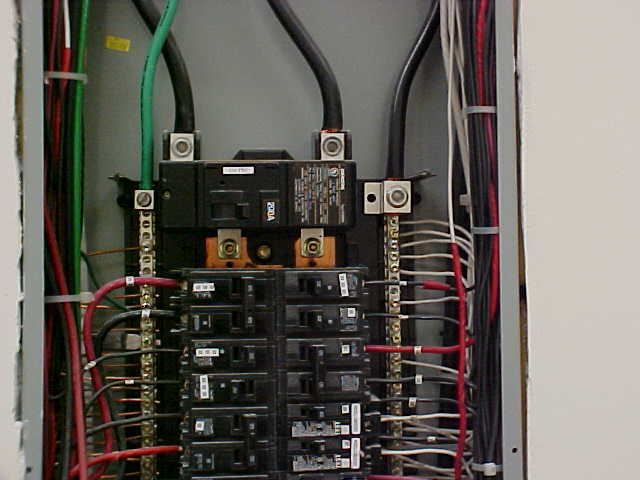

a couple of misc - a fairly good pict of the fireplace and two not quite as good picts of Kraigs breaker box -
