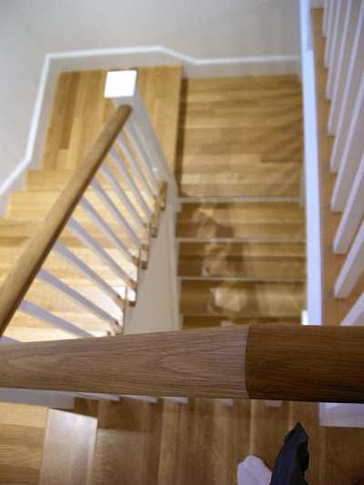

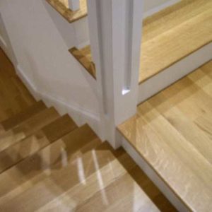

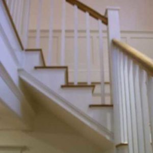

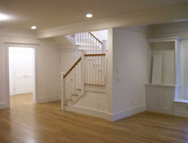

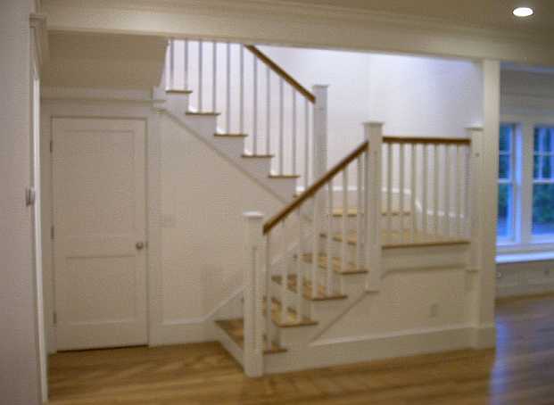

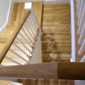

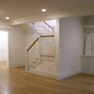

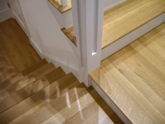

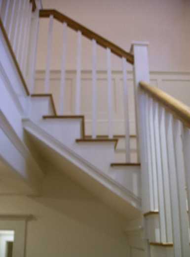

Here are the stairs I built in the house we’re just about finished with.  The house is based on one designed by Robert Stern as a Life magazine house of the year a while back, but there were substantial changes.  I don’t know if the stair design is from the original plans or our designers’ idea, but the cascading effect is nice when you are descending, sort of a figure “S” effect.

    Very clean. Did you make the newels yourself? The panels appear  to keep even margins with the stairs on each side, looks custom either way.
    1. woodguy99 | Jul 30, 2005 03:44am | #4
      Thanks guys.  The newels are Camberra, one of the fake mahoganies, wrapped with MDF to create the panel.  The post caps are also MDF.  I used lots of Bondo to clean up nail holes and glue joints.  We tried hard to keep all the reveals consistent.  I'm not crazy about the very top tread; there wasn't enough room for the basement stair door so we had to do it the way its shown in pic#5.
      All the treads are put down with PL Premium, and screwed and bunged with plugs cut from the tread off-cuts so the grain matches almost perfectly.

    Very nice, Mike......Made me dizzy looking down that one shot.....:)

    Very nice work, Mike.  Nice lines.  Did you lay the landing floors as well?  I found it was just as easy for me to lay the landing material during the stair process than to have the floor guy try to get it before or after me.

      Thanks Hook!  I laid the nosings on the landings, and the floor guy filled in.  I would have had no problem doing it but the timing worked out well for him to do it.  He did a really good job on the floors, about 3500 sf of quartersawn white oak.
