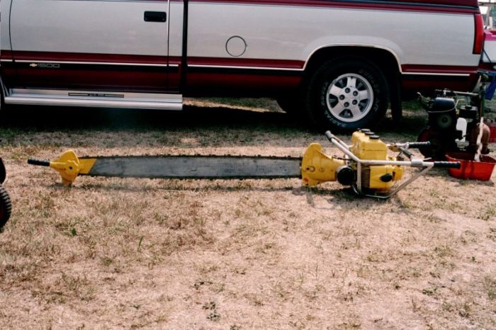

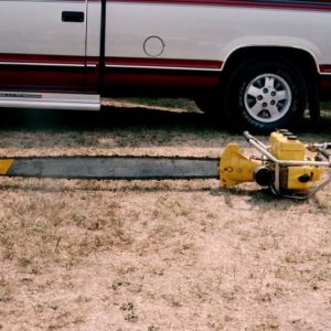

    BossHog | Oct 27, 2003 03:52am | #2
    Need one like this ???

    1. DavidxDoud | Oct 27, 2003 04:53am | #6
      actually,  I've got one similar - an old 'Mall' - I'll post a pict tomorrow if I get time - I've never run it,  tho it does have compression - I'd probably have to find two men to run it,  don't know if I would be up to it -
    2. r_ignacki | Oct 27, 2003 05:44am | #9
      ah, the interchangeble motor chain saw.
      I have heard of them, but never seen them.
      So, the yellow motor is for evergreens and the red motor is for hardwoods?
      Or is it vice - versa?       (g)!
