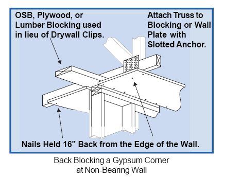

          BossHog | Mar 29, 2006 02:52am | #14
          The "Float-r" brackets are fine. But so is wood blocking. As long as the truss bottom chord can float, either one is fine.

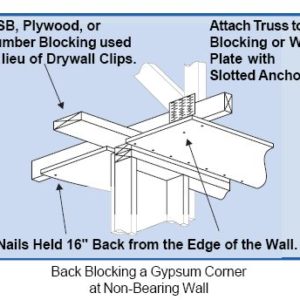

            What do you mean by "wood blocking"?Justin Fink - FHB Editorial
            BossHog | Mar 29, 2006 05:35pm | #19
            "What do you mean by "wood blocking"?"
            From the WTCA truss uplift documentation:
