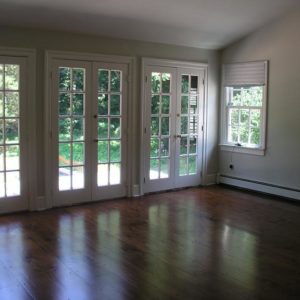

  6. andybuildz | Nov 25, 2005 06:01pm | #27
    Did my entire house over a year ago with eastern white pine wide plank. Some planks are as wide as 18" or better.
    Did different rooms differently to experiment. So far all the rooms haven't budged a milimeter.
    Some rooms I glued and face nailed with rose head cut nails. Some rooms I used red rosin paper and no glue and face nailed.
    All boards are square edged.
    I stacked and stickered all boards for over a month in the rooms.
    I let the boards sit after I installed them for over a month and filled any gaps between them that bothered me with elmers water base wood putty.
    I sanded all the floors with drum sanders then went over the entire thing with a ROS to get out all the chatter marks...ugh.
    Stained with a mix I came up with.
    Minwax 1 part cherry 3 parts english chestnut and one part thinner.
    I used a matte finish oil poly (three coats) in most of the house and waterlox (five coats)in the living room. If I ever did it again I'd only use poly on a job this size. Waterlox is a pain. Poly looks great to me. With a matte finish it doesn't have that plastic look "at all" and is hands down way more durable than the waterlox...trust me!!
    After well over a year not one drop of wood filler has come loose so....I think that says something about the installation.
    Be floored
    andy
