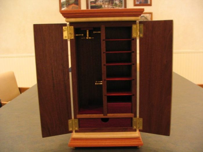

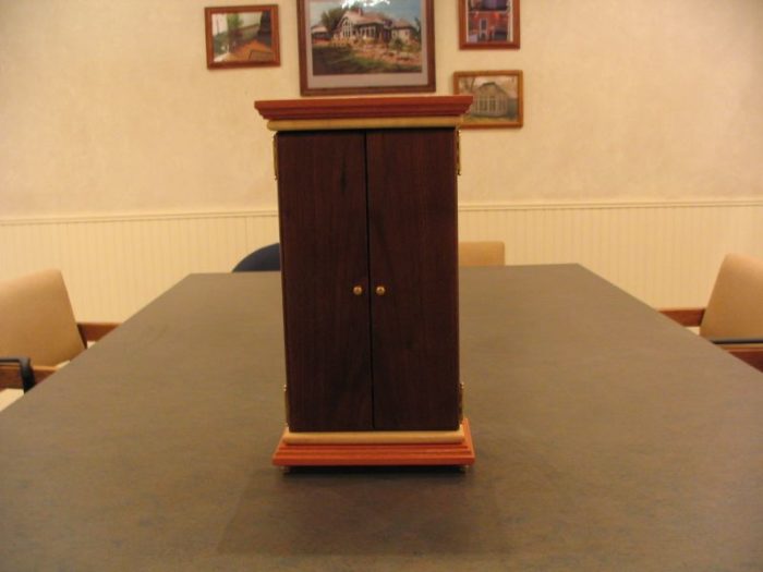

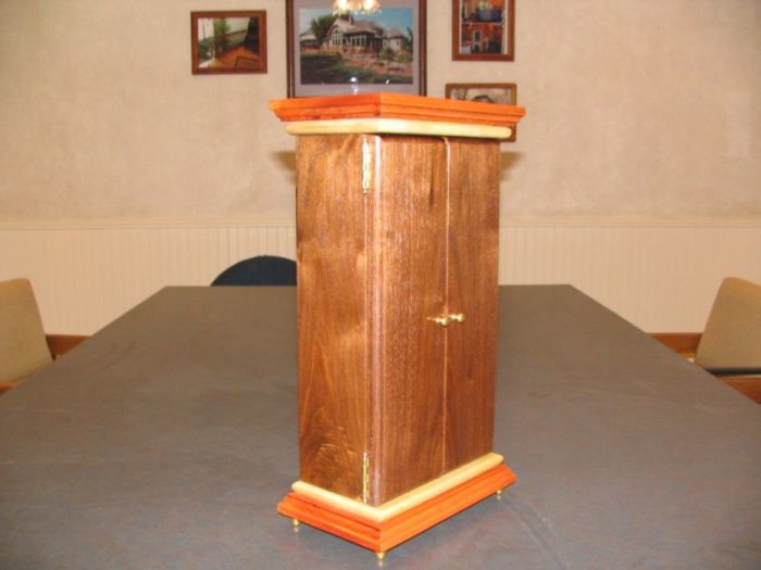

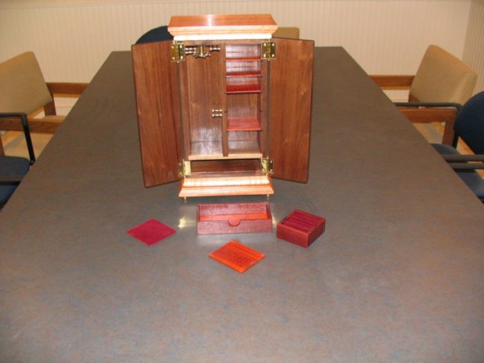

Just finished this up tonight, well almost finished, I want to put one more coat of finish on the outside, doors, and the earing holders.
The box is walnut with a Curly Maple and Lyptus top/bottom pieces. The drawers are made of Purple Heart with Paduk bottoms. The little drawer has velvet covered foam to hold rings, the Paduk slide out pieces are drilled to store her earings, and there is one piece of wood wrapped in velvet to go under the necklace side.
The finish is as of now, 7 coats of Tung Oil finish, Came out smooth as a baby’s
, Thanks RW
I’m not sold on the brass feet, what do you guys think?&
#160; Keep them or take them off?
You’ll also notice the brass posts for necklaces at the top are not at the same height, Whoops…
Other then that I’m pretty proud of this little box

I don't mind the brass feet, I'd leave em.
Uhh you staggerd the heights because necklaces are different lengths.:) At least that's what I would say.

That's what came to mind 2 seconds after I realized I goofed.... I did cause I measured some of your necklace's......

Edit - brass feet -- My DW would say they only allow for dust bunnies, IMHO, in deferring to my DW, have opted for full surface cork pads (but I get the cork free off old pallets or wallboards) .

Did you consider piano hinges?
Personal opionion, I'm not a big fan of piano hinges, not to mention, all those screws...

one other thing I wasn't happy with, the doors, to big of a gap between, once the hinges were morticed and screwed in and I noticed, didn't seem worth screwing with again...

I would take off the brass feet, except that they are the only thing that indicates which side goes down. They look a little too small.

Seriously - I wouldn't sweat things like the brass feet or the different heights of the post thingies. That fact that you got it done is MUCH more important than how perfect it is.

Honestly? it is great ! I think a better choice of hinges would make it PERFECT tho'. Soss hinges, or knife hinges really make a difference..but I am real picky about that stuff since I realize how much stuff I have made that should have had better hardware.
She'll love it I am certain.
To be honest I wasn't to happy with the hinges myself, I looked into SOSS hinges and I couldn't get the size I needed locally, and when I talked to the guys at woodcraft they were'nt convinced they would work for what ever reason.
I didn't think to use knife hinges, and I looked at some Nice hinges from Brusso however at 22 bucks a set I didn't think I needed 45 bucks in the hinges.
What I'm most happy with is the finish, which doesn't show as well in the pictures, but it's seriously smooth and just the right sheen for my taste.
