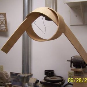

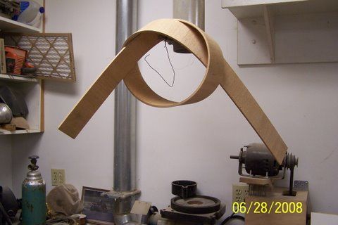

Thought there might be some folks in need occasionally, who don’t know about this stuff.  This is an 8′ x 4″ rip of 3/8″ wiggle wood (4×8′ sheet of bending plywood).  Daughter said – can you tie it in a knot?
Yes.

  2. cmiltier | Jun 29, 2008 05:15am | #2
    I just used a piece for the seat of a curved chair. Worked perfect and a ton easier than gluing up solid wood and shaping with rounds.
    I tied it in a knot also. Kids want to know if I can make a slide for the pool.
    The stuff I used is 3/8" and solid on both sides. The grain all runs the same direction. There is a very thin piece of veneer in the center.

    We've always called it "wacky wood".  I once used it to laminate up a curved rim joist for an interior balcony.  It was pretty fun.  I'd nail one layer of 1/4" on, roll on a thick coat of Tite-Bond with a heavy knap roller, and apply the next layer.  Lather, rinse, repeat.  It worked out really well.
    The stuff we had was similar to what another poster described.... finished both sides, grain running in all the same direction, and a thin darker layer in the middle.  I remember that when ordering it I could choose which direction I wanted the grain running.... depending on how I was going to use the sheet.
    I also saw a tight conical tower sheathed in two layers of it once as well.  Not my frame though.
