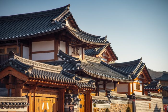

My post might have been confusing. Not a writer by trade...Here's a photo of what I am thinking to build probably worth more than any typing could convey.
Goals are to create all the curves with the correct proportions while designing a structural ridge and purlins to break up the rafters into two spans. Cut the curves in each rafter span to make the overall curve parallel to the common gable rafters. Design it ahead of time efficiently to have the engineer size everything. Building is 26'x50'. No interior load points to be had.
