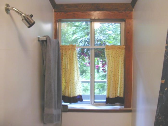

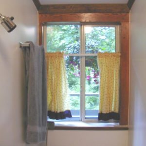

    Our window for reference
    Edited 6/8/2008 10:14 am ET by junkhound
    1. Henley | Jun 08, 2008 05:34pm | #24
      I like it!
      Looks like yours is laid out so the spray doesn't really hit the window much at all.
      Mine will definitely get hit some, not in the direct line of fire but
      right there.

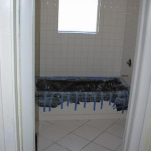

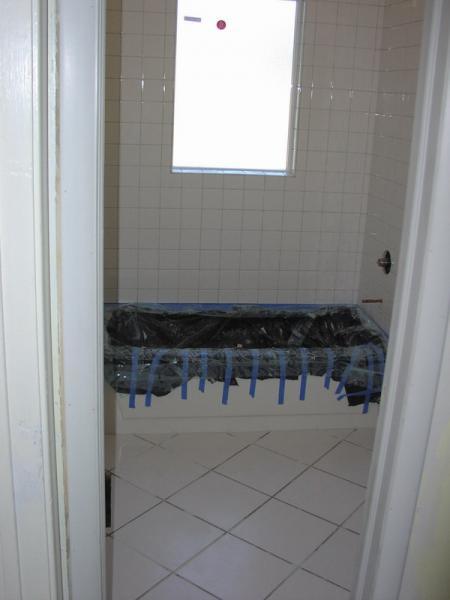

    I've done three showers with windows and love the light it brings into shower. I did modify the process somewhat every time. As far as I know all are functioning without problem. I was meticulous on the details thinking it's gotta be waterproof before the tile or backer. Have not done Kerdi but don't see where it would change things in a big way. I never used an opening window, light was the only consideration for a small room and all had vent fans.
    First one was tempered obscure single pane glass in wood frame I made.
    Second was a dual glazed tempered insert, again a made up frame and external stop. Smooth glass to shower.
    Last, which is pic, was a vinyl frame dual glazed, again obscure.
    All were similar sequence. Building paper pans and wrap whole opening. 1/2" backer sloped to inside at 10 degrees or so , 1/8" gap  at window and poly roof caulk all around. Thinset tile all around, gap at window, this caulked with silicone.
    Esthetics wise I liked the look of direct glass to tile interface of the first two, but the vinyl frame simplified the install and met budget. If I were doing it for my own house, I'd do it that way or maybe f'glass frame with as little exposure inside as possible. I might consider stone one piece sill for ease of cleaning, but like the look of tile. Basically building a niche with a glass back.
    This pic is pre-grout.  Missed getting one after I completed, but you get the idea.

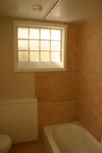

    Here's one with glass block.
    Billy

        Henley I can get a picture of what I am talking of tomorrow and post it. It is at my sisters house that is why after fifteen year I still have access to it. It is total wood inside and out, saved the glass block for the shower wall on that one. Did her upstairs the same way when we built the dormer. That leads to the only problem I have had with it. The upstairs bath is directly above the down. When I put the dormer in for her the new weight made the downstairs window stick a bit. a few properly placed trim screws took care of it. That is the only problem they have had. It is high enough it does not get drenched with water but you still have a view. I think I set the header right up against the top plate. Up stair to get it higher since the walls are 7' plus a little I used Trust Joist header material Timer strand which has a depth as small as 4 3/8 inches.Wallyo

      1. CAGIV | Jun 11, 2008 02:38am | #39
        I'm not a huge fan of vinyl windows myself but like all things, there are good products and ####.  Most of what you see is ####.
        As mentioned above there are fiberglass windows as well, Marvin has a line and so does Pella.  Most people here hate Pella, I've used their fiberglass windows on 2 jobs so far and they seem like a good product.
        Then there's always glass block which if done properly can look nice inside a shower.
