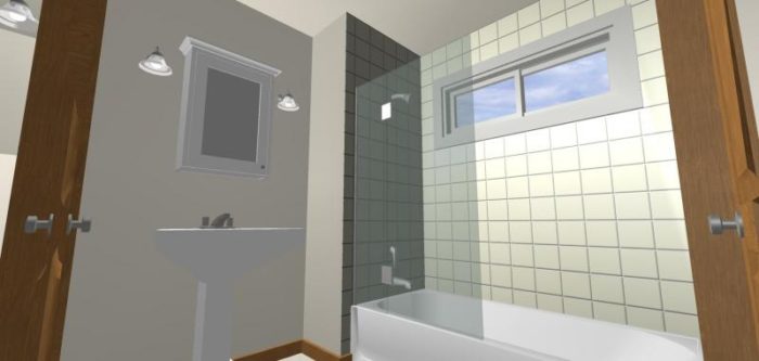

A window is desired in a bathroom, and the only place to put it is in the tub/shower wall. See the pic attached. What is shown is a glider window, specified as an all-Ultrex unit from Marvin Windows. No wood, sash or frame. All components are pultruded fiberglass, just like the to-the-weather frame parts of an Andersen Frenchwood hinged patio door. The way the config is recommended for a slider in this application, is for the sash joint to be on the side away from the showerhead. No problems that way. Jamb extensions and and sill will be either cut stone or solid surface material. Although the pic shows casings, there will be none. Tile surround will join to jamb extensions and sill, with adequate sealant detailing done. What other window products (no vinyl please) might be considered here?

      You make some good points. The window on the shower side should be detailed as if it is the outside of the house.

        I went with solid vinyl, awning type. I framed it with azek and have had no problems.
