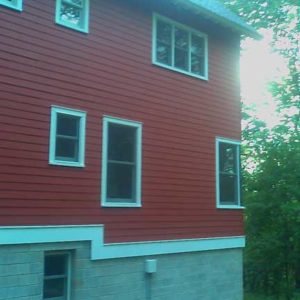

I am getting ready to remove a window (4 year old K&K) in order to install a new direct-vent coal stove.  In the attached picture, it is the big one one in the middle on the first floor.  I have fiber cement siding with a combination of Miratec and pvc trim.  I would like to leave the trim intact and infill the opening with more siding and paint all to match the house.
My concern is how to remove with minimum damage and more importantly, how to properly flash.  I had flashed over the nail flange on the side and head in proper “fine homebuilding” fashion.  I am having a hard time getting this figured out in my head and I was hoping for some good advice. I don’t want to tear the window out and stand there scratching my head while I have a big hole in the side of my house.

  1. frammer52 | Aug 27, 2008 09:21pm | #1
    Reciprocating saw off the nail flanges, CAREFULLY!

  3. Piffin | Aug 29, 2008 01:44am | #3
    I'd take it all th e way out and clean siding over. That window does absolutely nothing for the appearance of that side of the house.
    But if I had a customer who absolutely wanted to keep the trim there for some strange reason, I would leave the window too and maybe replace the scree with MDO painted to look like a window, remove the sashes from inside to allow for insulation, and get with the program.
