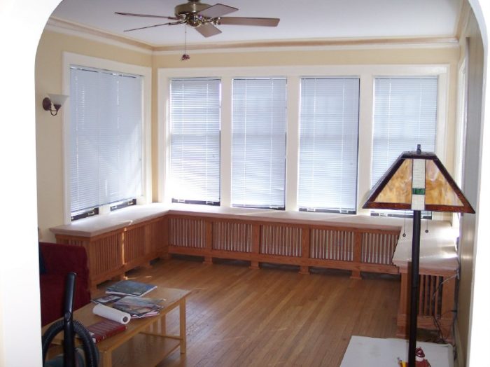

Had some fun building a couple of benches. The one built into the dormer was the seat featured in FHB a couple months ago. Only big change was this one is all oak. enjoy! |

are the seats in the first through 3rd pic attached or free standing? from the side view they look like they stand away from the wall?
The top is attached at the window sill. The top of the right section is removable for access to the radiator.

what is the material for the cap / seating bench sandstone?
The bench top is oak, it's just waiting for a finish. I built the base and had that finished before I installed the top.

Do you have a closeup of the bench joinery or maybe just describe your process?
I thought I saw a radiator pipe on the left hand side ...
what's the backing material behind the slats?

You are correct. The left side is hiding the radiator. I used a piece of sheet metal and rapped over the top of the radiator to direct the heat out the front.
I didn't put any backing behind the slats, it's just open, you can see the wall.
