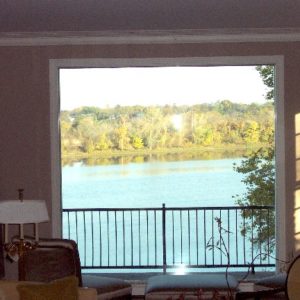

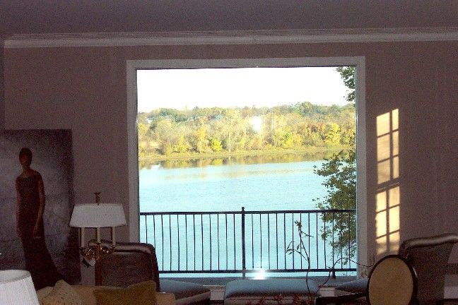

      1. calvin | Nov 02, 2003 05:03pm | #10
        A large window in a wall is pretty darn good looking.Remodeling Contractor just outside the Glass City.
