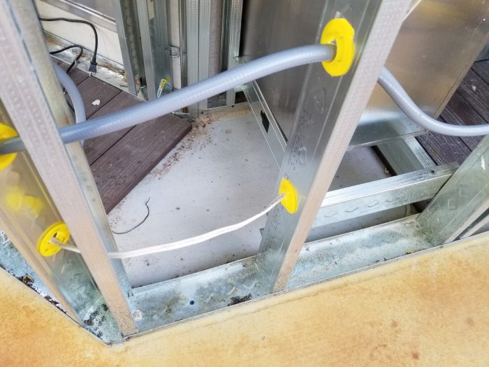

  5. JAJW | Apr 28, 2021 11:17am | #10
    Hello,
    I am building a outdoor kitchen island with metal studs. My question is a 2 part electrical one. I had some 12/2 UF-B wire left over that I am using. It will be wired to a 40 amp GFCI subpanel. The attached photo shows how I am running the wire, is this OK? If this works, what kind of electrical boxes will I need? Can I just use plastic one? I see a lot of videos that they just use MC and metal boxes for out door islands.
