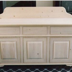

          I made a whitepine sink cab that had a 5/8ths groove around it for a 5/8ths beaded noseing ( can't find a pic yet). The router slipped somehow and I wound up with a NICE divot, right above the doors!
          I used a forstner bit to enlarge the hole to 3/4" and plug cut a tite red knot, glued it in  and rerouted..WHEW. Saved my keester.
          That count? LOL  Spheramid Enterprises Architectural Woodworks

            Found it.
            The fix is above the left door.
            It now has his and her sinks, tip out drrawer trays and full extension drawers in the center door, they are wired for curling irons, ele tooth brushs and the like...
            The cab was a royal pain in the butt.  Spheramid Enterprises Architectural Woodworks
