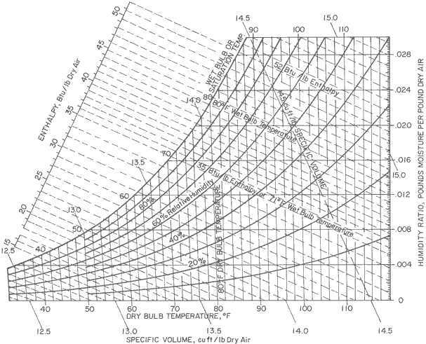

            mmoogie | Mar 09, 2008 07:21pm | #13
            Frenchy,You are both right. Moisture content effects wood. Temperature effects the RH of the air, which in turn effects the moisture content of the wood, which in turn effects the expansion or contraction of the wood.Does anyone have a source for the chart that shows the changes in atmospheric RH relative to temperature? ie: If the RH is 45% and the room is at 50 degrees, then you raise the temp to 70 degrees, the RH will now be ?? lower because 70 degree air can hold more moisture.Steve
            mmoogie | Mar 09, 2008 08:55pm | #15
            mmoogie,I found the chart (psychrometric chart) and found something else too...an online calculator where you can plug in any two known variables and your elevation above sea level, and it'll calculate all the other variable you could want...http://www.uigi.com/WebPsycH.htmlNow if I could just find a chart that showed the expansion co-efficient for various species of lumber at various moisture contents, and what the the Equilibrium Moisture Content of a given species will be when under what given atmospheric conditions...mmoogie
