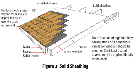

          6. Piffin | May 04, 2009 01:19pm | #27
            CU shows how to lay the felt with shakes.They are typically 24" long laid with 10" to th e weather.Shingles are more often 16" long and laid 5" exposed. you end up with a triple ply of shingles plus headlap but only a double ply of shakes. The irregularities of the shakes can mean a 3/8" gap or so between them for water to be driven in. Shingles are much smoother, often sanded and re-squared, lay with only about 1/8" between them, just to account for swelling when wet.
