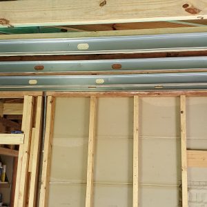

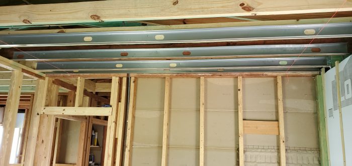

Thank you all for replying. I am going with the metal studs. I ordered a 360 laser level which I am still waiting for. I will post pics when complete. I appreciate all of you.

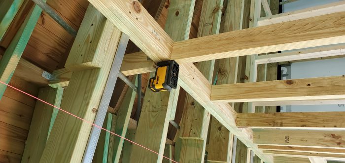

Does someone have a laser they like for this? Shall I position the laser 1" below the new joist height and use a spacer to position the new joists?

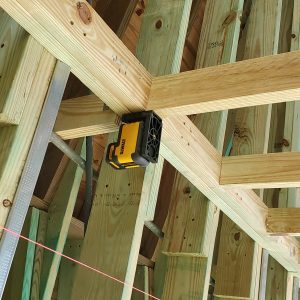

I bought a 360 Dewalt laser level. It has worked fine for what I am doing, cost me around 179.00. I bought it through amazon.
