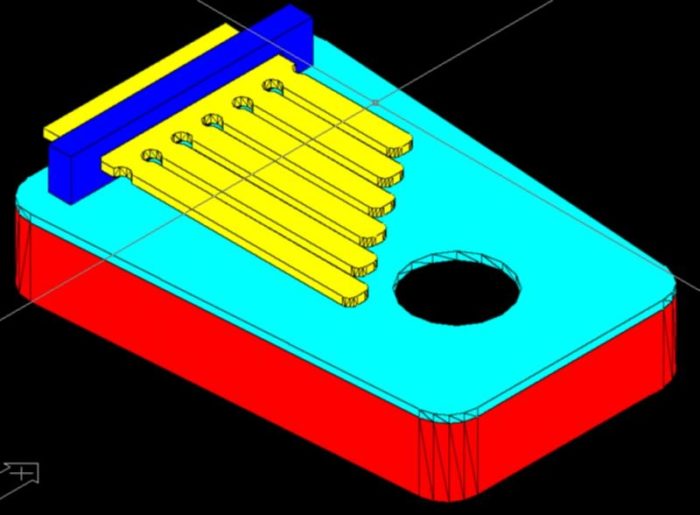

            CapnMac | Jul 05, 2005 07:57pm | #9
            not something you would be afraid to let a 3rd grader loose with.
            How about something like this, then:
            I can cobble some dimensions together, if needed.
    CapnMac | Jul 05, 2005 07:24pm | #8
    making a wooden marimba for kids?
    'Course a "real" marimba is a sound box with a bit of trimmed spring steel clamped to it.  Not exactly rocket science, other than patiently cutting the metal fingers out so as to not leave sharp edges.
    With wood, I want to remember some "craft" destruction books recommending opposing wedges to hold the "fingers" to the sound box, the better to be able to replace the fingerpiece if (when) needed.  I also remember that a lamination was recommended for more "springiness."
    Oh, and most of the ones I remember were all hand-played--i.e., hands around the sound box, and thumbs used to play the fingers.  (Saves not having a "hammer" as an alternate toy-of-much-destruction and/or toy-of-much-attention when played upon the good china or crystal . . .)
