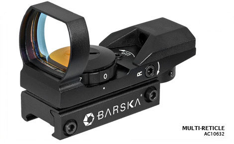

    Gene_Davis | Dec 31, 2006 01:13am | #4
    I prefer to drill them, rather than let them drill on my house.
    My preferred drill is a Ruger .22 autoloader, MK II, stainless with a heavy long barrel, and outfitted with a Barska red dot holographic sight.

      Do you use a Glaxco Kydex holster by chance?
        Gene_Davis | Dec 31, 2006 09:53pm | #11
        No.  With my Ruger wearing the sight shown here, I am not sure what kind of holster, short of something custom, might work.
