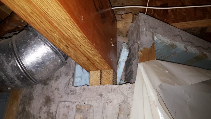

I’m in the process of finishing our basement. It’s got some roughed in by the previous (original) owner and I think they did most of the work themselves. I’m finding a ton of stuff wrong. My dad is a carpenter so I’ve developed a small amount of intuition regarding things being done right/wrong. Here’s one place I’m on the fence about. This beam stretches the entire length of our house and is supported on the ends and at two places in the middle (total ~45′). Each end rests on the foundation wall but and both ends are shimmed. The one side however looks precariously perched on a couple of treated bocks. I feel like I want to jack up the beam, ever so slightly and replace the blocks with pieces of stacked treated plywood. Then again, it’s lasted 20 years this way… What do you all think?

    I’ve always used steel shims for beams and was rewarded I guess when the strictest county inspector passed our roughs and finals without a second trip.
    Later I picked up composite shims from some iron workers. In a couple inspections those were passed as well.
  2. fsmyles | Sep 29, 2020 06:10pm | #2
    I would replace existing shims with stacked steel plates on a bed of nonshrink grout. Done.
    Frankie
    Tpripps | Sep 30, 2020 03:57pm | #3
    Follow up question: How should I go about jacking up the beam to get the old "shims" out? cribbing and a bottle jack? Would a jack post have enough oomph to lift the beam (and the whole rest of the house)?
    sawdust_steve | Oct 01, 2020 10:29am | #4
    You aren't really trying to "lift" the beam you are just going to take the weight off of it. You can use a bottle jack but it needs to be rated for the amount of load on the beam. I would install enough cribbing or a 6x6 post under the beam during the operation incase the jack falls out while loading it up
  5. danbrassaw | Oct 01, 2020 09:44pm | #5
    A "stack" of pt material would essentially have the same crush strength as whats there. Orienting the blocks vertically would result in less grain gushing. Personally, I wouldn't bother messing with it unless it appears that its wet there and there's a risk of the PT deteriorating more quickly than usual.
  6. dgeist | Oct 02, 2020 10:04am | #6
    Important question: Is the current position good? If it's sagged and you need to fix it, shim it as you see described above. If its close enough to level to make you happy, I'd source or fabricate a bracket that bolts into the wall and up the sides of a beam just to stabilize it and keep it where it is for the long run. 3/8 or 1/4 x 3" angle steel up the sides of the beam (and bolted) welded to a section of 1/4" plate steel (and maybe boxed at the bottom edge of the beam ) and affixed to the slab with structural lags would do it and be fairly inexpensive. That would also keep you from having to jack up the whole house.
    Plumb13 | Oct 02, 2020 07:26pm | #7
    If it ain't broke, don't fix it.
  8. makita888 | Dec 24, 2020 02:33pm | #8
    I see this alot I would go with steel plates and lit
    it just enough to remove pt slide the shims in and release the weight cant see the need for a bracket joists and weight will keep i t in place
