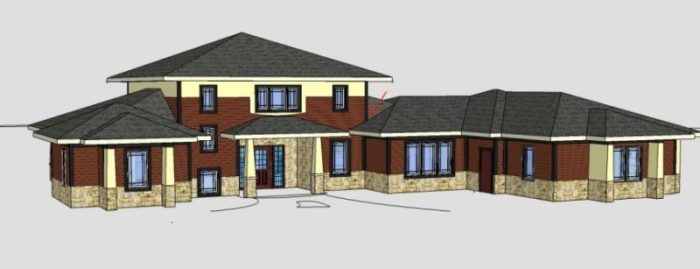

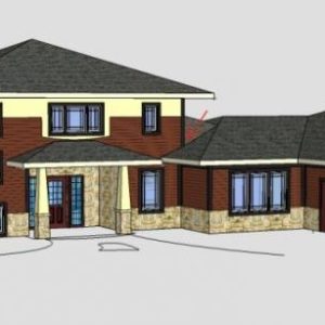

      One area was the solar tube. I think that was fixed. The second area is a corner of the house, where it transition from 2 to 1 story. Because of the roof layout at this location, there is a lot of water flow along where the roof meets the wall. See my rendering-Third is a mystery to me. Water was dripping out of a J-box on an exterior wall. Again an area that transitions from 2 to 1 story.In these areas, we are talking about steady dripping. Enough to make 1 or 2 feet diameter stains and some standing water.
        zak | May 12, 2006 06:30pm | #13
        That valley/wall intersection is exactly where I thought it might be leaking.  That spot needs some great flashing work to stay leak free, and if the final siding/roofing isn't on yet, you're probably asking too much.  If the flashing is still exposed there, I'd go take some pictures of it, and inspect it closely.  Post a picture on here, if you can get one that shows what's going on.zak

          look like one of those conflicte roofs with half-azzed attempts to deal with dead valeys. Designers need to learn that gravity works and water flows downhill

        Yes, that is what I though might be a blind valley.  And if water runs down teh roof and comes close to a wall like that, you sure need teh flashing done correctly.

        I can't get a good idea from this picture. Is the valley with the red straight all the way down or does it jog around the corner of the main house?How did this valley/house intersection get flashed? Is the leak at the bottom of the valley or midway down?
        1. tufenhundel | May 12, 2006 09:58pm | #23
          Lemme get back to you when I got some pics.
